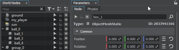

Organizing Nodes

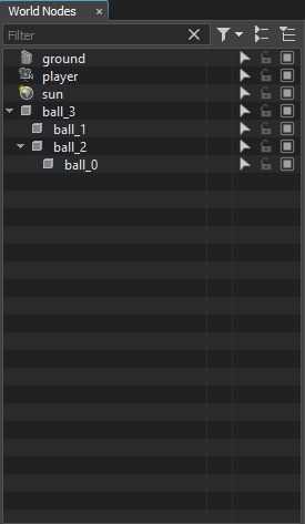

In Unigine, nodes are organized in a hierarchy that can be managed via the World Nodes window.
To open this window, choose Windows → World Hierarchy in the Menu.
World Nodes Window

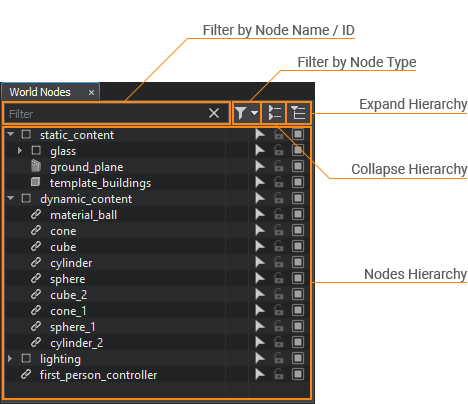

As you can see, this window allows filtering nodes by name and type, collapsing and expanding nodes hierarchy (i.e., showing only the parent nodes and hiding the child ones or showing all nodes added to the world), and changing nodes hierarchy - rearranging, reparenting, cloning, renaming, deleting, and grouping the nodes.
When building a hierarchy, take into account multi-threaded update of dependent nodes.
The World Nodes window contains all nodes existing in the current world. Some nodes can be instances of the asset files: meshes, sounds, terrains, instanced nodes, or nodes stored in the *.node files.
When you add a new node to the scene via the Menu Bar (the Create menu) or by dragging it from the Asset Browser, it is automatically added to the nodes hierarchy and displayed in the World Nodes window.
In front of the name of each node, there is a set of icons:
To manage these icons, click Filter by node type and specify the icons you want to show or hide in the Show Columns section. Note that the state icon always stays visible.

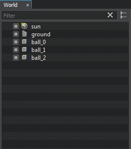

Toggling Nodes#

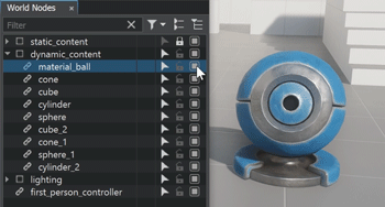

To toggle a node on and off, left-click the checkbox in front of it. If the flag is unchecked, the node will not be rendered.
Toggling a node on and off

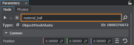

A node can also be renamed in the Parameters window:
Renaming via Parameters Window

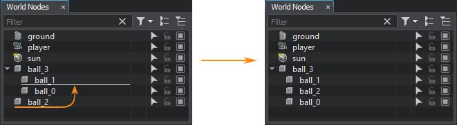

To move a node to a specific position in the hierarchy, drag it with the left mouse button pressed.
Moving a Node in Hierarchy
The position in the hierarchy, where the node will be placed, is highlighted with the white line:
Highlighted Position

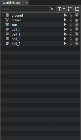

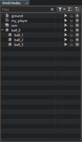

Nodes in the scene have hierarchical arrangement: each node (parent node) can have multiple children (child nodes). It allows you, for example, to change the transformation of several nodes only by transforming the parent node.
To collapse or expand the list of child nodes, click the arrow to the left of the parent node.
You can also collapse all child nodes in the World Nodes window by clicking , or expand the list to see all nodes in the World Nodes by clicking .
By default, a new node added to the scene is positioned at the root level of the nodes hierarchy. You can set up its inheritance in one of the ways described below.

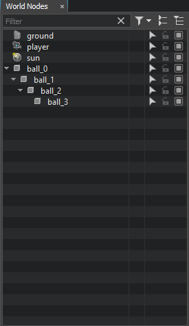

Making a Parent Node#

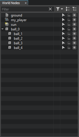

To make one node a parent for the other node (or several nodes), select both the parent and the desired child nodes, right-click the parent node, and choose Make Parent in the drop-down list:
By using this option, you can perform reparenting for the hierarchy tree branch: select the target branch, right-click the desired parent node and choose Make Parent in the drop-down list. It produces the following:
  1. The new-made parent is always placed at the root level of the hierarchy.
  2. The child nodes positioned at the different hierarchy levels are placed at the same level.
Reparenting Nodes

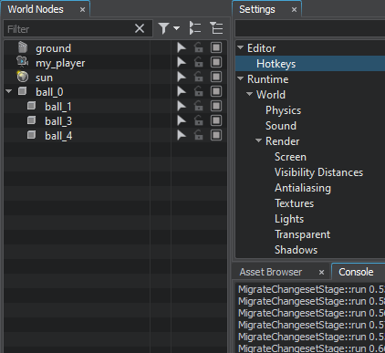

Making a Child Node#
To add one node as a child to the other in the hierarchy, or reparent a node, drag it holding the left mouse button to the desired parent node.
Adding a Child Node
The parent node to which the node will be added, is highlighted with the white frame:
Highlighted Parent Node
You can also move a node to a specific position alongside the child nodes of the desired parent: the node will be added as a child to this parent node.
Moving Node As a Child

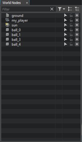

Filtering nodes simplifies their management in a large world.
You can select which node types to display in the World Nodes window: click and choose the required node types. Here, you can also specify how to view the filtered nodes - as a flat list (Flat List View) or according to their hierarchy (Hierarchy View).
You can temporarily show all objects by clicking Enable All. At that, the current filter settings will be preserved.
Filtering Nodes

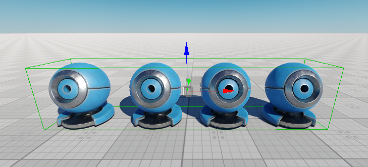

Grouping nodes allows managing several nodes simultaneously. The grouped nodes can be transformed as a single node relative to a pivot point
When grouping nodes, a new Dummy Node is created, and all selected nodes become its children. At that, the hierarchy of grouped nodes persists.
To group nodes, select them, right-click, and choose Group in the drop-down list or press Ctrl+G:
Grouping Nodes
The grouped nodes can be selected and transformed as a single node:
Grouped Nodes
