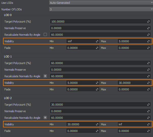

UNIGINE enables you to automatically generate LODs for your high-poly model right when importing it, saving you a lot of time cause now you don't have to prepare levels of detail manually in some third-party software. The feature is based on the meshoptimizer library.
To automatically generate LODs on importing the model into UNIGINE, simply drag it to the Asset Browser and perform the following:

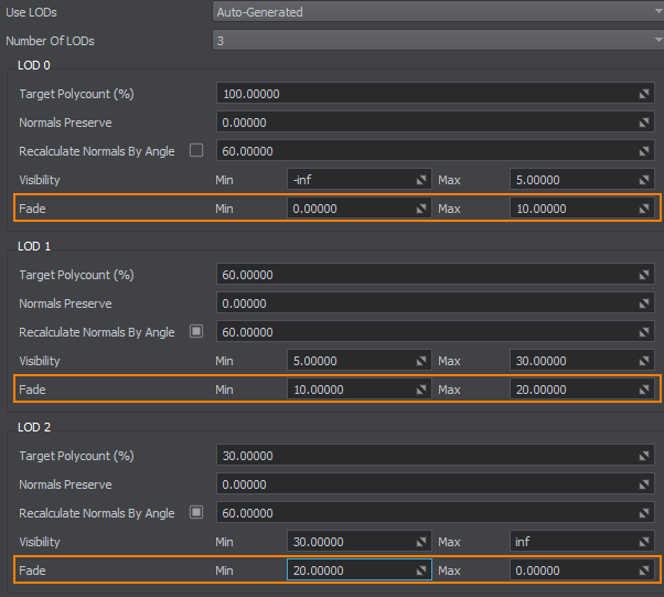

  1. In the import settings window, choose Auto-Generated in the Use LODs drop-down list.
  2. Set the required number of LODs. For example, we will generate 3 LODs.

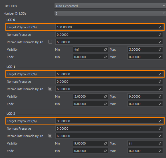

  3. Specify the Target Polycount (%) value for each LOD. It defines the degree of geometry simplification for each LOD.
    • For LOD 0, leave the default value of 100 percent.
    • For LOD 1, set the 60 percent of the original number of polygons.
    • For LOD 2, set the 30 percent of the original number of polygons.
  4. Specify the minimum and maximum visibility distances for each LOD. Maximum visibility distance of each LOD should be equal to the minimum visibility distance of the next LOD. Maximum visibility distance of the last LOD should be equal to inf.
    • For LOD 0, leave the default Min distance and set the Max distance at 5 units. It means that no matter how close the camera comes to the mesh, the surfaces will still be visible.
    • For LOD 1, set the Min and Max distances at 5 and 30 units. It means that when the camera is 5 units away from the mesh, the first LOD surfaces won't be visible and the second LOD surfaces will be shown over the distance of 30 units.
    • For LOD 2, set the Min distance at 30 units and leave the default Max distance. After 30 units, the second LOD surfaces won't be visible and the third LOD surfaces will be shown.
  5. Specify the minimum and maximum fade distances for each LOD:
    • For LOD 0, leave the default Min distance and set the Max distance to 10 units. It will prolong the distance over which the LOD surfaces are still visible and provide smooth fading.
    • For LOD 1, set the Min distance to 10 units. After 5 up to 15 units, the second LOD surfaces will smoothly fade in. The Max distance set to 20 units. After 30 up to 50 units, the second LOD surfaces will smoothly fade out.
    • For LOD 2, set the Min distance to 20 units and leave the default Max distance. The third LOD surfaces will start to smoothly fade in from 30 to 50 units.
  6. Leave the 0 value for the Normals Preserve option to ignore normals while simplifyign the mesh topology.
  7. Leave the default 60 value for the Recalculate Normals by Angle option.
The Engine will generate and configure all LODs automatically using the specified settings.

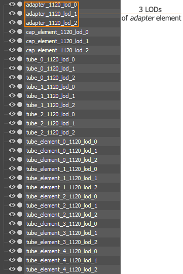

  1. Create several meshes for different LODs of your model: a detailed mesh for the closest LOD and a number of less detailed meshes for farther LODs.
    When naming the meshes, add a postfix to specify the LOD each mesh represents. For example: _lod_0 for the 1st LOD, _lod_1 for the 2nd LOD, etc.
    For example, for each mesh representing an element of the tubes constructor (10 meshes), there are 3 meshes representing LODs:

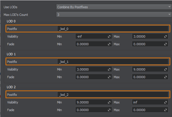

To import the model into UNIGINE, drag and drop the previously exported FBX file to the Asset Browser and perform the following to automatically create LODs based on the name postfixes:

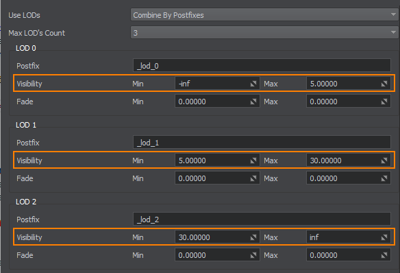

  1. Choose Combine By Postfixes in the Use LODs drop-down list.
  2. Specify the maximum number of LODs stored in the FBX container (in our case, 3).
  3. For each LOD, define a postfix that will be used to group objects in an FBX file into a corresponding LOD.
    The postfix must be the same as the one used when creating objects in a 3D editor.
    For the tubes constructor model, the following postfixes should be specified:
    Names of generated surfaces will be as follows: material_name + LOD_postfix.
    • For _lod_0, leave the default Min distance and set the Max distance at 5 units. It means that no matter how close the camera comes to the mesh, the surfaces will still be visible.
    • For _lod_1, set the Min and Max distances at 5 and 30 units. It means that when the camera is 5 units away from the mesh, the first LOD surfaces won't be visible and the second LOD surfaces will be shown over the distance of 30 units.
    • For _lod_2, set the Min distance at 30 units and leave the default Max distance. After 30 units, the second LOD surfaces won't be visible and the third LOD surfaces will be shown.

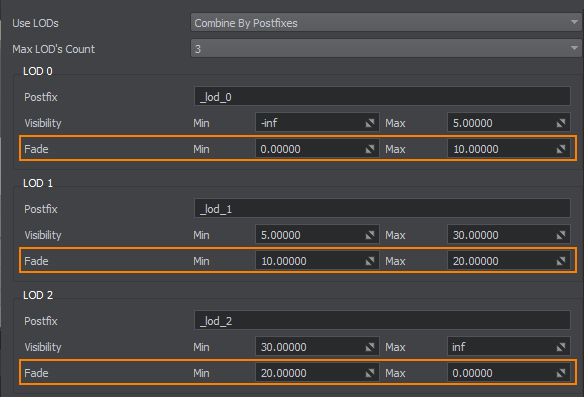

    • For _lod_0, leave the default Min distance and set the Max distance to 10 units. It will prolong the distance over which the LOD surfaces are still visible and provide smooth fading.
    • For _lod_1, set the Min distance to 10 units. After 5 up to 15 units, the second LOD surfaces will smoothly fade in. The Max distance set to 20 units. After 30 up to 50 units, the second LOD surfaces will smoothly fade out.
    • For _lod_2, set the Min distance to 20 units and leave the default Max distance. The third LOD surfaces will start to smoothly fade in from 30 to 50 units.

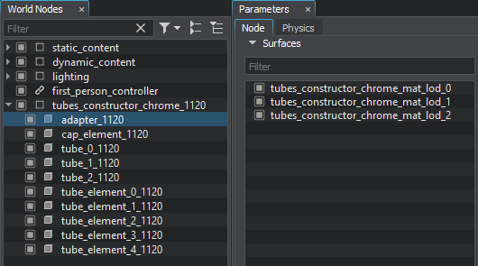

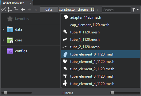

In the result, the FBX container with 10 meshes will be imported. Each mesh will have 3 surfaces representing LODs.
Meshes of the Imported FBX
When working with large scenes, you cannot know for sure how many LODs some model will have. So, it is recommended to specify more LODs in the importer: in this case, you won't have to set up LODs manually, if the model contains more LODs than the previously imported one. For example, if you set up 10 LODs in the importer, you can import models with up to 10 LODs.
Step 3. Add Model to the World#

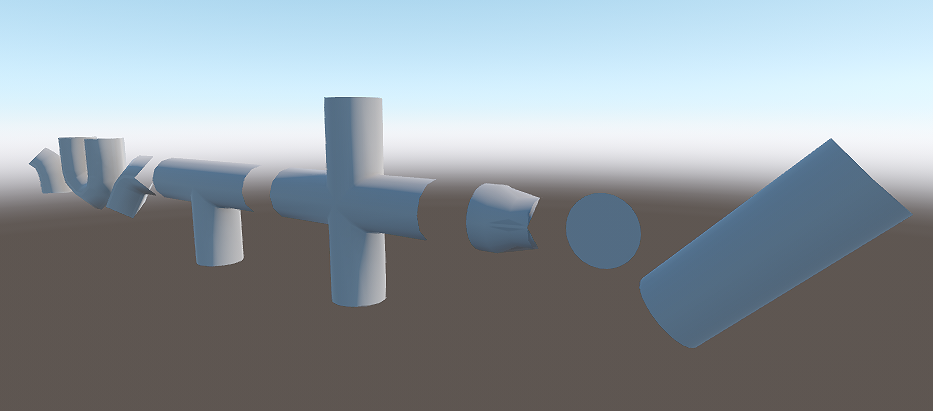

Add an exported model into the world as described here. All LODs will be already created and set up according to the specified import values:
Imported Tubes Constructor with LODs
FBX Added to the World
If required, adjust the LODs surfaces in the Node tab of the Parameters window:
  • Configure the Min and Max Parent settings. In this tutorial, we use the default values of 1.
Try to move the camera forward/backward to check how LODs are switched:
LODs Switching

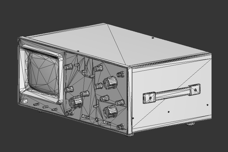

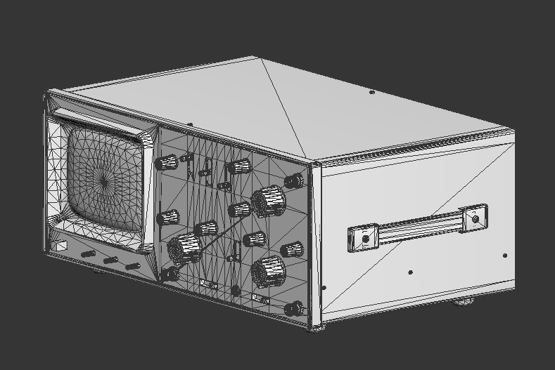

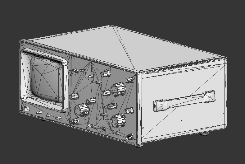

  1. In your 3D editor, create a detailed model and a number of models with a low number of polygons. For example, you can just copy the existing detailed model and reduce the number of polygons.
    You should create a separate LOD for each part of the model to which a unique material is assigned.
    As an example, we will use the model of an oscilloscope from Superposition benchmark (available via UNIGINE SDK Browser). This model already contains 3 LODs.
    10109 polygons 5004 polygons 2583 polygons
    LOD 0
    LOD 1
    LOD 2
  2. Generate LODs according to a pipeline used by your 3D editor. For example, in 3ds Max, you should group meshes representing LODs and then create LODs via the Level of Detail utility.
  3. Export the model with LODs as an *.fbx file.

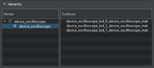

  2. In the Import FBX window, enable the Merge Static Meshes option. Otherwise, LODs will be imported as separate meshes, not surfaces.
  3. Import the model.
If you select the imported FBX, its content will be previewed in the Hierarchy section of the Parameters window.

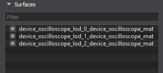

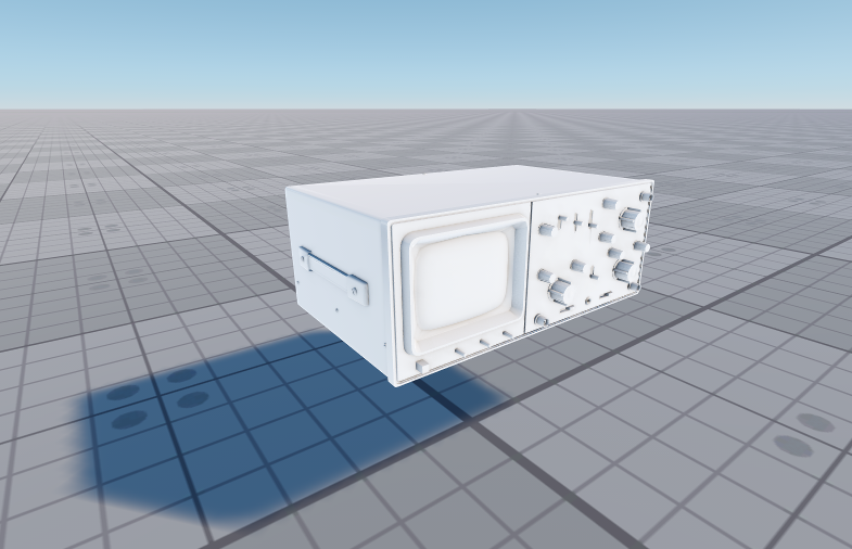

Add an exported model into the world as described here. By default, all surfaces (LODs) are visible at the same time:
Oscilloscope Model

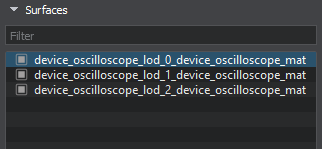

The surfaces of the exported model that represent LODs can be found in the Node tab of the Parameters window:

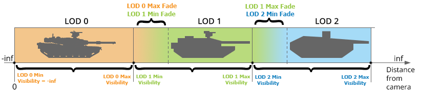

For each LOD surface, you should specify a visibility distance and a fade distance. The following image illustrates these distances and how they work.
For setting up the LOD surfaces, do the following:
  1. Open the World Hierarchy window, and choose the added node.
  2. In the Surfaces group of the Node tab (the Parameters window), choose the first LOD surface:
    • Set its Maximum Visibility distance to 5. It means that when the camera is 5 units away from mesh, the first LOD surfaces won't be visible.
    • Leave the Minimum Visibility distance at -inf. It means that no matter how close the camera comes to the mesh, the surfaces will still be visible.
    • Set the Maximum Fade distance to 10 units. It will extend the distance over which the LOD surfaces are still visible and provide smooth fading.
    You can disable other LOD surfaces to see the result of the current LOD surface settings.
  3. Choose the second LOD surfaces and:
    • Set the Minimum Visibility distance of the second LOD surfaces to start exactly where the Maximum Visible distance of the first LOD surfaces ends: at 5 units. It means that when the first LOD surfaces begin to fade out, the second LOD surfaces will be shown.
    • Set the Maximum Visibility distance at 30 units. After 30 units, the second LOD surfaces begin to fade out and the third LOD surfaces will be shown.
    • Set the Minimum Fade distance to 10 units. After 5 up to 15 units, the second LOD surfaces will smoothly fade in.
    • Set the Maximum Fade distance to 20 units. After 30 up to 50 units, the second LOD surfaces will smoothly fade out.
  4. Choose the third LOD surfaces and:
    • Set the Minimum Visibility distance to 30 units. It means that when the second LOD surfaces begin to disappear, the third LOD surfaces will be shown.
    • Set the Maximum Visibility distance at 300 units. After 300 units the third LOD surfaces totally disappear.
    • Set the Minimum Fade distance to 20 units. The third LOD surfaces will start to smoothly fade in from 30 to 50 units.
    • Set the Maximum Fade distance to 50 units. After 300 units, the mesh will begin to smoothly fade out.
      If you want to leave the last LOD surface always visible, set the Maximum Visibility distance to inf.
