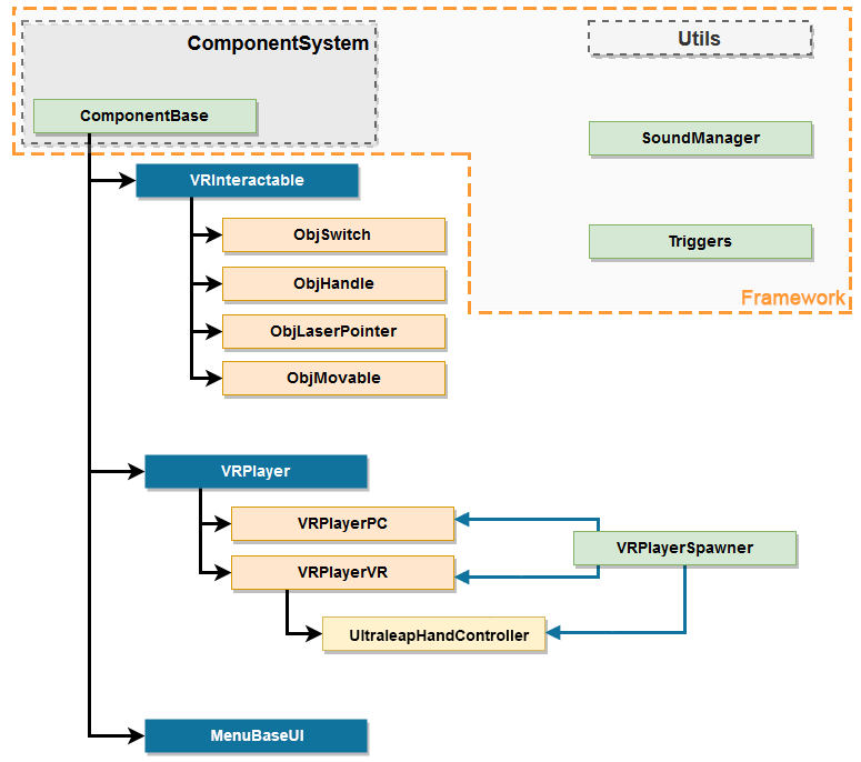

When you open your project based on the VR Sample for the first time and see a lot of different classes, you might get confused a bit. But let's take a quick look at each of them to see what they actually do and how they are connected.
VRInteractable Class#
This is a base class for all objects that you can interact with. It defines a basic set of interactions, in other words: here you define what can a user do with your object. You can add your own type of interaction here.
The following component classes are inherited from the VRInteractable:

VRPlayer Class#
This is a base class for all players. It contains declaration of baseline controls, common basic player operations, callback management etc.
You can check out baseline controls for VR Controllers here.
The following component classes are inherited from the VRPlayer:

VRPlayerSpawner Class#
This class registers all VRPlayer components in the Component System. It checks that VR is initialized and spawns the VRPlayerVR.
In case if VR was not initialized, a VRPlayerPC is spawned.
MenuBaseGUI Class#
This is a base class for all graphic user interfaces (GUI).
The following component classes are inherited from the MenuBaseGUI:

Framework includes the Component System which implements the core functionality of components and a set of utility classes and functions used for playing sounds, auxiliary math and 3d math functions, callback system implementation.
Triggers Class#

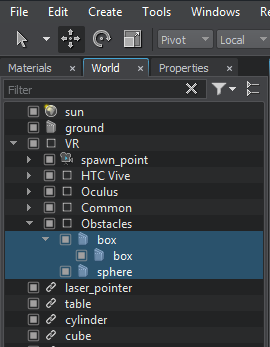

You can simply create primitives for walls and objects in your room and add them as children to the node dummy named Obstacles, which is a child of the VR dummy node (see the hierarchy in the Editor below).
All children of the Obstacles node will be automatically switched to invisible mode and will be used only to inform the player and prevent collisions with objects in the real room.
Primitives used to mark obstacles must have their first surface (the one with the 0 index) named as "box", "sphere", "capsule" or "cylinder" in order to be properly converted into corresponding trigger volumes.
