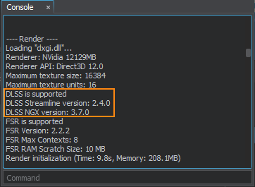

The upscalers are initialized on render initialization. To verify whether they are supported and initialized after application startup, you can do one of the following:
  • Check the Render section of the console output.
  • Run the dlss_info and/or fsr_info console commands.
For example, the Render section may provide the following information:
Source code
---- Render ----
DLSS is supported
DLSS Streamline version: 2.4.0
DLSS NGX version: 3.7.0
FSR is supported
FSR Version: 2.2.2
FSR Max Contexts: 8
FSR RAM Scratch Size: 10 MB

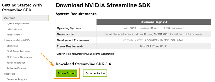

  1. Follow this link to download the NVIDIA Streamline SDK, which serves as a wrapper for DLSS and all its features.
  2. Click Access Github.

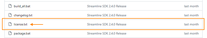

  3. Before proceeding, review the license details and make sure you accept all of its terms and conditions:
    1. On the page that opens, find the license.txt file in the list of files and folders.
    2. Open the file and read the text carefully.

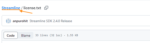

    3. Switch to the repository homepage by clicking Streamline.

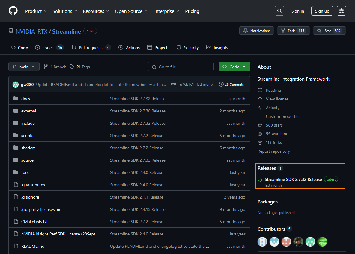

  4. Switch to the repository homepage by clicking Streamline as you did previously.

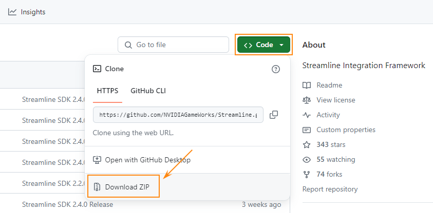

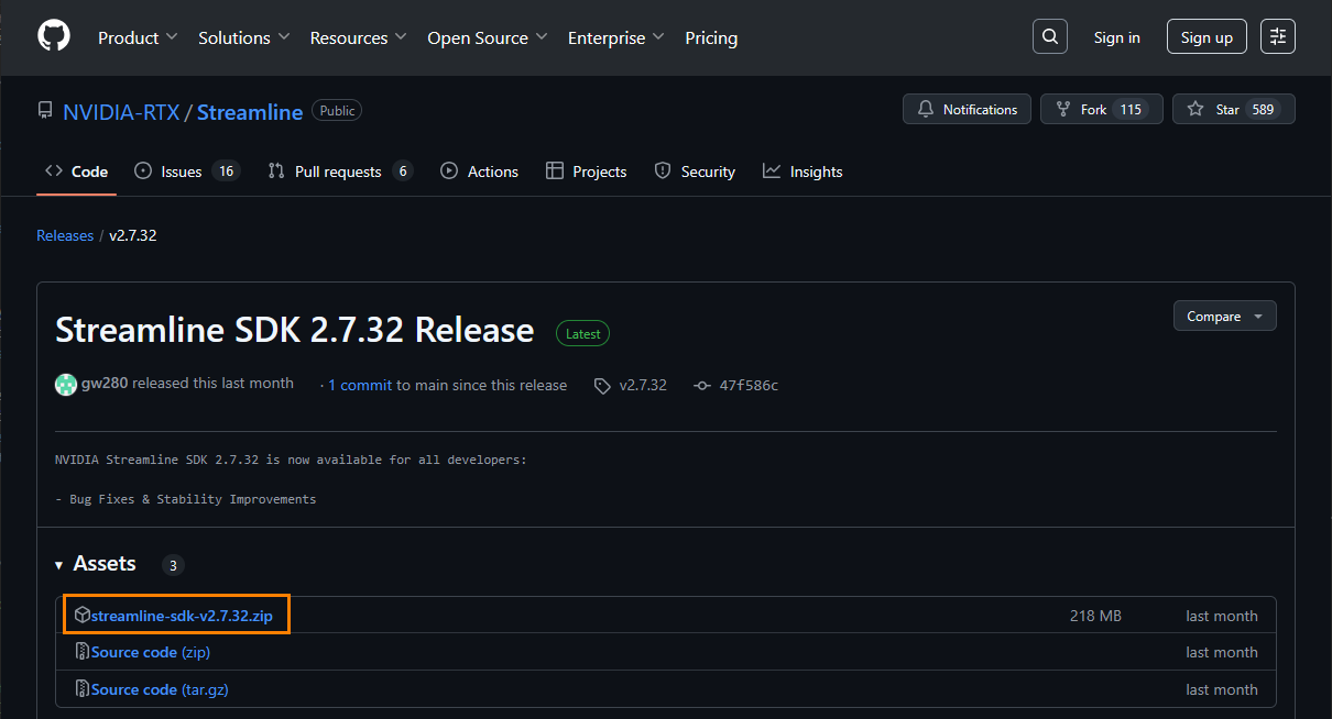

  5. Download Streamline SDK 2.7.32 Release. Click on the Releases link:
    Find Streamline SDK 2.7.32 Release and download the archive:
  6. Extract the ZIP archive. By default, it is extracted to the streamline-sdk-v2.7.32 folder. However, you can rename it if necessary.

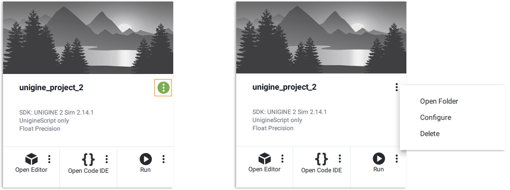

  9. Copy these files to the bin folder of your UNIGINE project:
    By copying the license file, you confirm that you accept all the terms and conditions it provides.
    1. Find your project in the UNIGINE SDK Browser and select Other Actions -> Open folder.
    2. In the directory that opens, find and open the bin folder.
    3. Copy the 5 files listed above.

  13. In UnigineEditor, open the console and check that DLSS is available. The corresponding information is provided in the Render section:
    If DLSS is not available, the corresponding message will be shown in the console.

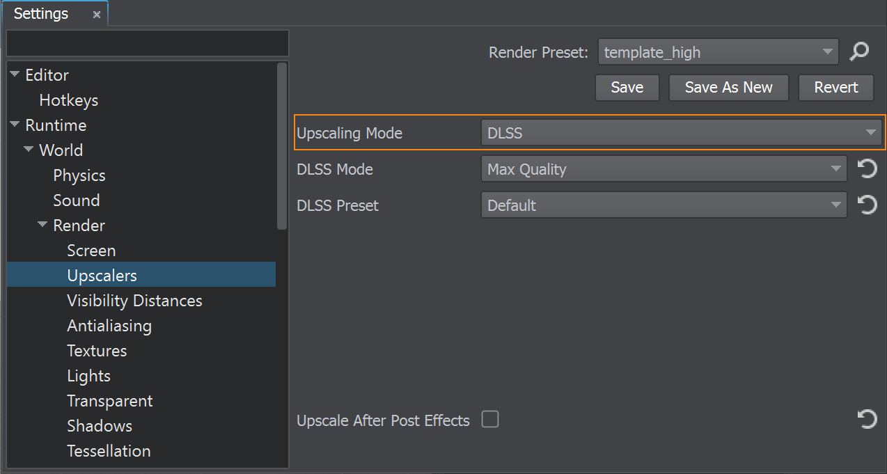

To use DLSS for the scene, enable it in one of the following ways and specify settings:
  • Via the UnigineEditor interface:
  • Using the render_upscale_mode console command:
    Source code
    render_upscale_mode 2

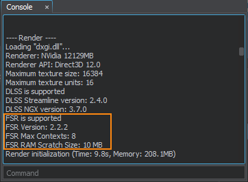

Before applying FSR 2 upscaling, you should check if it is available. In UnigineEditor, open the console and check the information provided in the Render section:
If FSR 2 is not available, the corresponding message will be shown in the console.

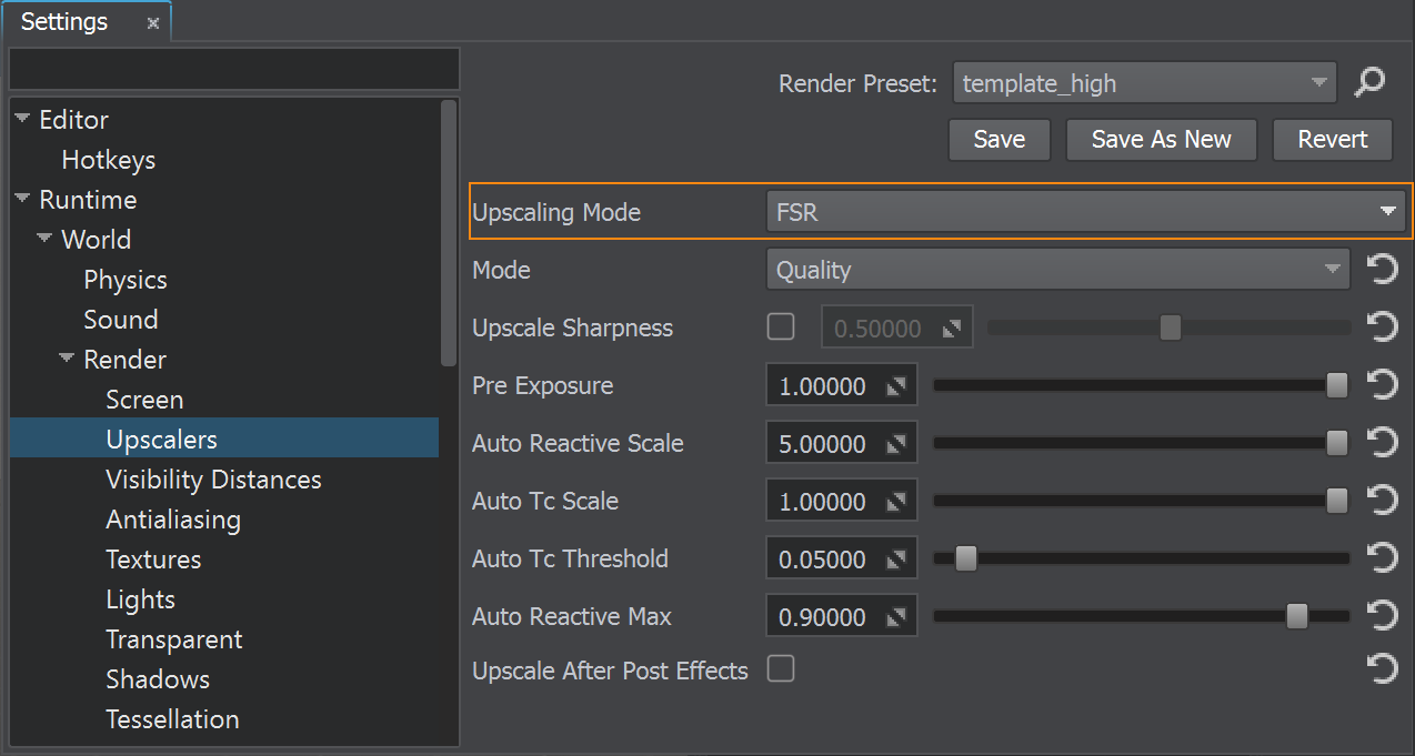

To use FSR 2 for the scene, enable it in one of the following ways and specify settings:
    Source code
    render_upscale_mode 1

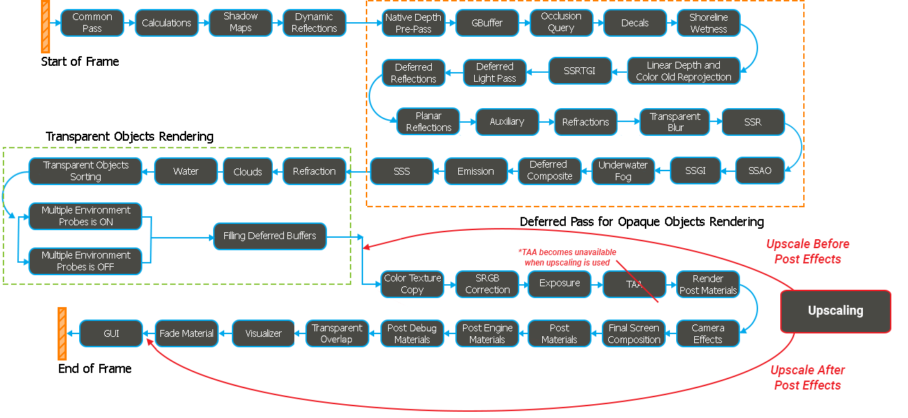

When to Apply Upscaling#
By default, upscaling is applied before all post-processing effects are rendered. However, you can choose to apply upscaling after rendering the post-process effects.
It can be done via the console using the render_upscale_post command or in UnigineEditor by toggling the Upscale After Post Effects parameter.
