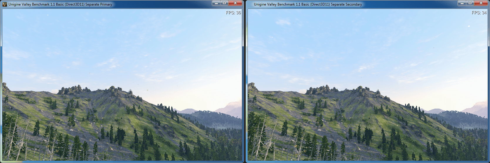

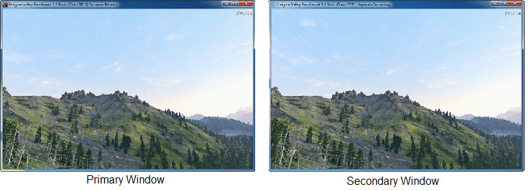

The Separate plugin is used to create a separate window for each eye. It can be used with any devices that support separate images output, e.g. for 3D video glasses or helmets (HMD)
  • The Separate plugin is available only on DirectX 11 graphics API. So it can be used under Windows only.
  • This plugin cannot be used in a Qt-based application.
Separate can be rendered in both the windowed and the full-screen mode.
