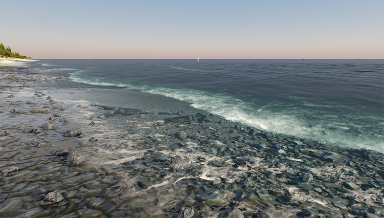

Swash zone created by using FieldShoreline object.

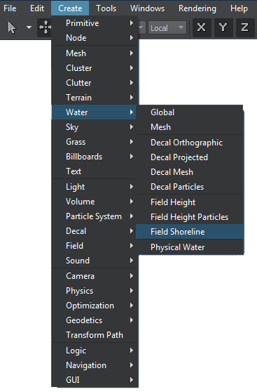

  1. On the Menu bar, choose Create -> Water -> Field Shoreline.

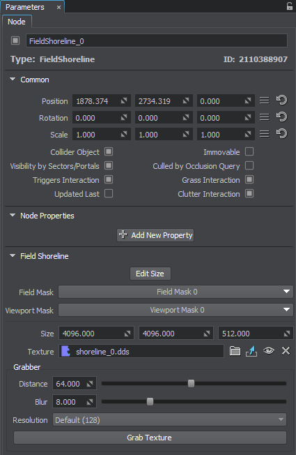

  3. Go to the Node tab of the Parameters window, set up necessary parameters and grab the shoreline texture.
After adding a FieldShoreline object to the scene, you can't see any changes of the global water object because FieldShoreline object doesn't have any default texture.

In the Field Shoreline section (Parameters window -> Node tab), the following parameters of the shoreline field can be adjusted:
Setting Bit Masks#
Field Mask A field mask. A bit mask that specifies an area of the shoreline field to be applied to water. The shoreline field will be applied to water only if they have matching masks.
Viewport Mask A viewport mask. A bit mask for rendering the shoreline field into the current viewport. For the shoreline field to be rendered into the viewport, its mask should match the camera viewport mask.
Setting Shoreline Parameters#
Size Size of the shoreline field along the axes in units. A large FieldShoreline object provides less detailed swash zones.
Texture Shoreline texture. Grab the texture to fill that field.
Grabber Parameters#
Distance Padding distance (from shore to the beginning of swash).
Blur Blur coefficient (make shoreline smoother).
Resolution Grabbing texture resolution.
Grab texture Grabbing texture button.
