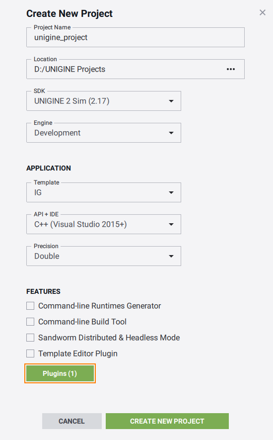

  1. Create a new project using the IG Template as described here.
    Create a Project using the IG Template and Component System

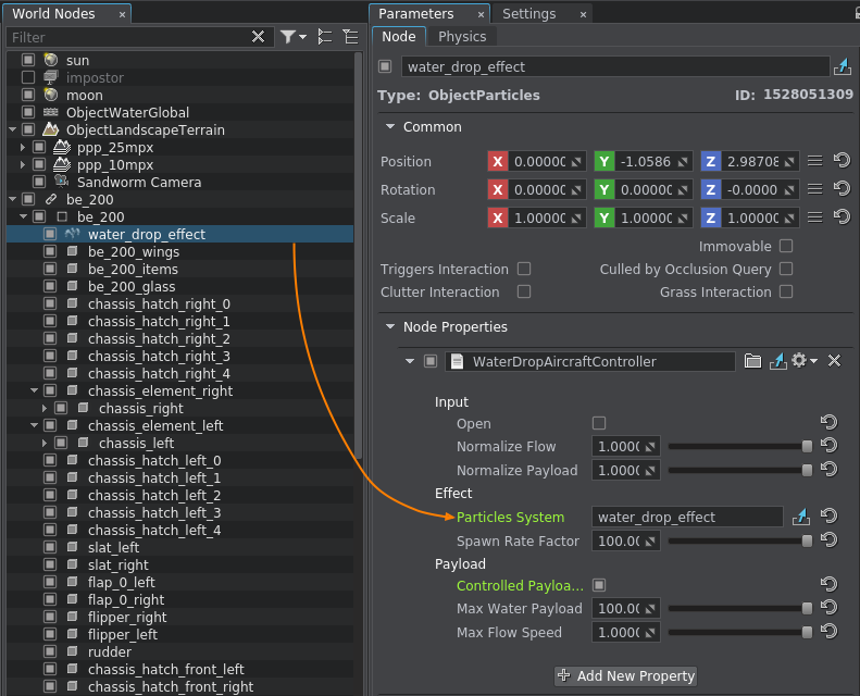

  4. Via the UNIGINE Editor, assign the new created property file (WaterDropAircraftController.prop) to a node, for which the component was created (Be-200 in our case).
    Create a Particle System in the UNIGINE Editor and set its parameters as required. Add this Particle System to the corresponding field of the property.

  3. Build and launch your project. At the initialization stage, a property file named RotatorIGNetwork.prop is created.
  4. In the UNIGINE Editor, assign the created property file to a node, for which the component was created.
  5. Save changes and run your application.
