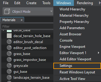

  2. Create a new material by inheriting from the recently created grayscale material in the Materials Hierarchy window.

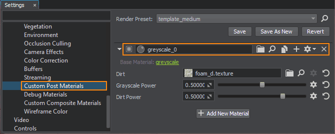

  3. Open the Settings window by choosing Windows -> Settings from the main menu
  4. In the Settings window choose Runtime -> World -> Render -> Custom Post Materials and specify the name of the child grayscale material in the field.

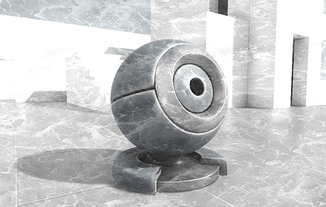

    The grayscale post-effect will be applied.
  5. Configure your post-effect by adjusting the Grayscale Power and Dirt Power parameters.
    The final scene.
