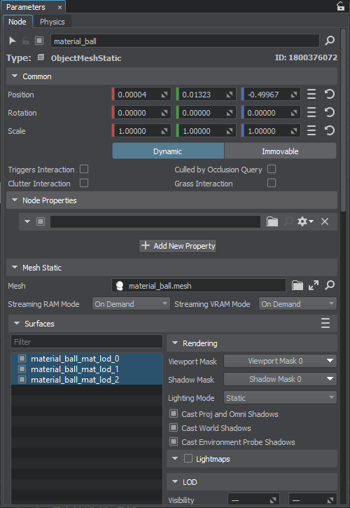

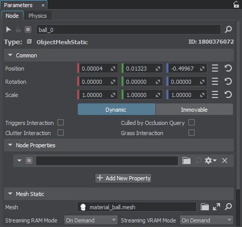

The multi-purpose Parameters window provides access to parameters of the currently selected node.
Parameters Window with Node Settings
If the window isn't opened, choose Windows -> Add Parameters in the main menu.
Via this window, you can change a name of the selected node, toggle the node on and off, modify the node's transformation parameters, its visual representation, set up physics, and assign properties.
The node-related data is organized into two tabs:
  • Node tab contains general and node-specific parameters. For example, settings for object-related nodes include surface settings, such as rendering, LOD, intersection, collision, material, and property.
  • Physics tab contains settings of the node's physical body.
The node parameters on each tab are grouped in separate panels, and each panel is expanded by default. You can collapse panels by clicking the arrow to the left of the panel name.
