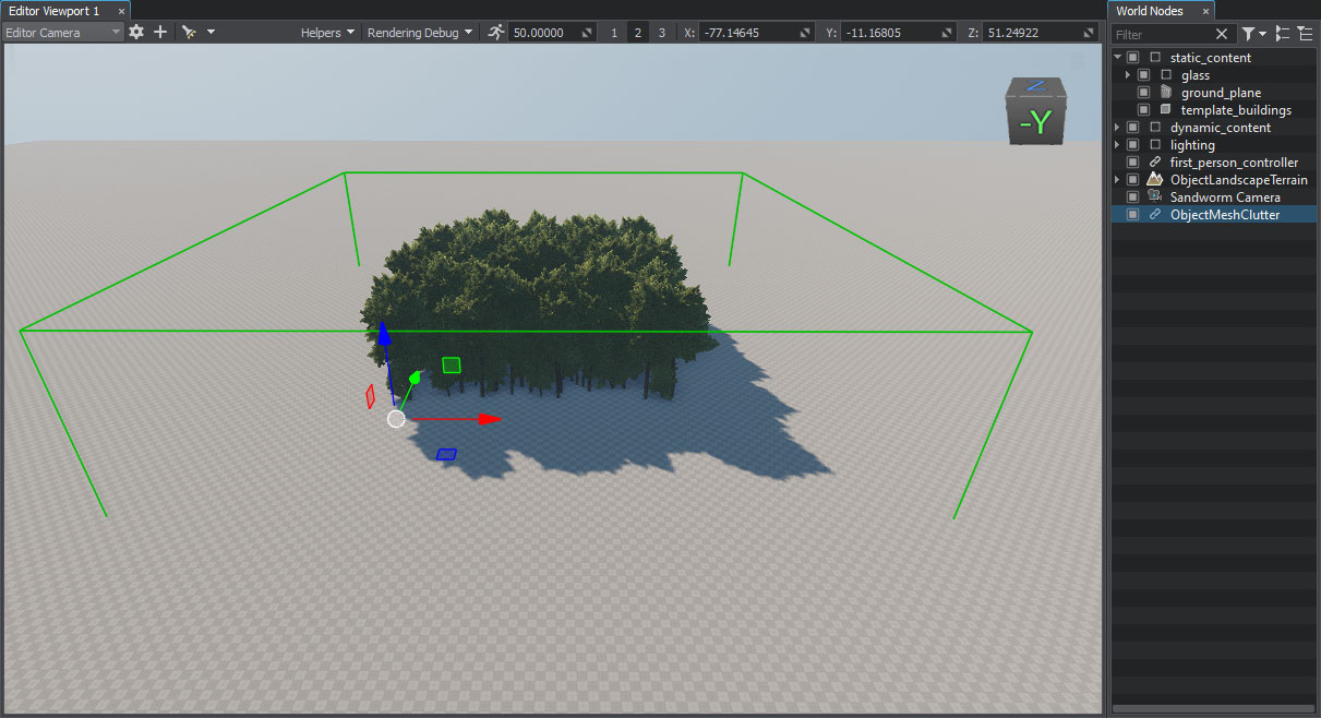

Let's create a Mesh Clutter object with a tree.
You can omit the creation process and use a ready-made Node Reference sw_georeferenced/nodes/vegetation/pine/pine_clutter.node.
  1. In the scene, click Create -> Clutter -> Mesh. In the window that opens, select a mesh: sw_georeferenced/nodes/vegetation/pine/fbx/pine_01_2.FBX/pine_01_2.mesh and place it somewhere in the scene.
  2. Specify parameters of the primary object in the Parameters window: assign the materials from the sw_georeferenced/nodes/vegetation/pine/materials/ folder to the corresponding surfaces, increase the visibility distance of the Mesh Clutter, etc. For more details, see this article.
    Intersections with the parent object must be enabled for all types of primary objects. The Intersection flag can be found on the Parameters tab of the object.
  3. Open the folder in the Asset Browser where you want the primary object be stored, right-click on the created ObjectMeshClutter and convert it to Node Reference.
The primary object is ready — we will use this Node Reference to generate vegetation.
Created primary object
You can remove it from the scene at all or disable if you'll require it later for further adjustments.

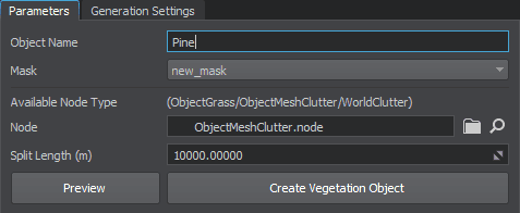

Adding the Vegetation Object#
  1. In the Objects panel, click + for Vegetation.
  2. Set the following parameters for the object:
    • The object name is set for convenience. This name will be displayed in the Objects list in Sandworm and in the World Nodes hierarchy after generation.
    • As you have only one mask, it is selected by default in the Parameters panel.
    • Set the prepared primary object as Node (or use an asset from the pack).
  3. Click the Create Vegetation Object button.
You can edit any parameters of the created vegetation object in Sandworm — changes are saved automatically.

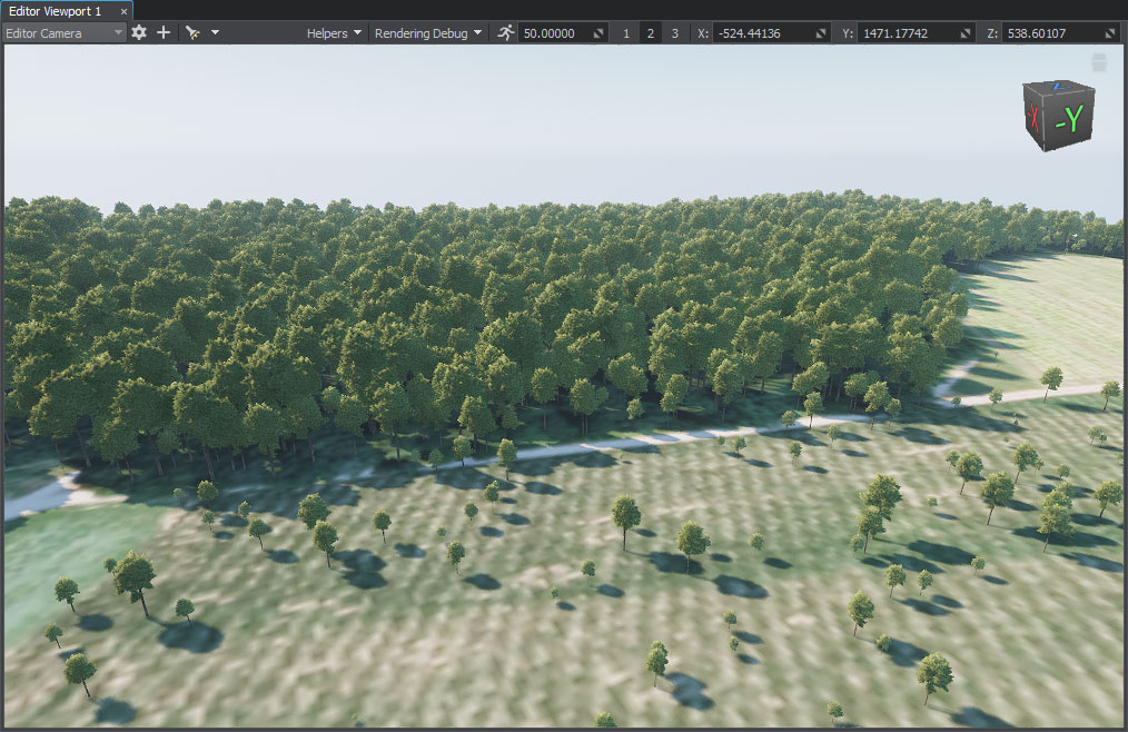

Generated Vegetation#
The generated trees:
Generated trees
