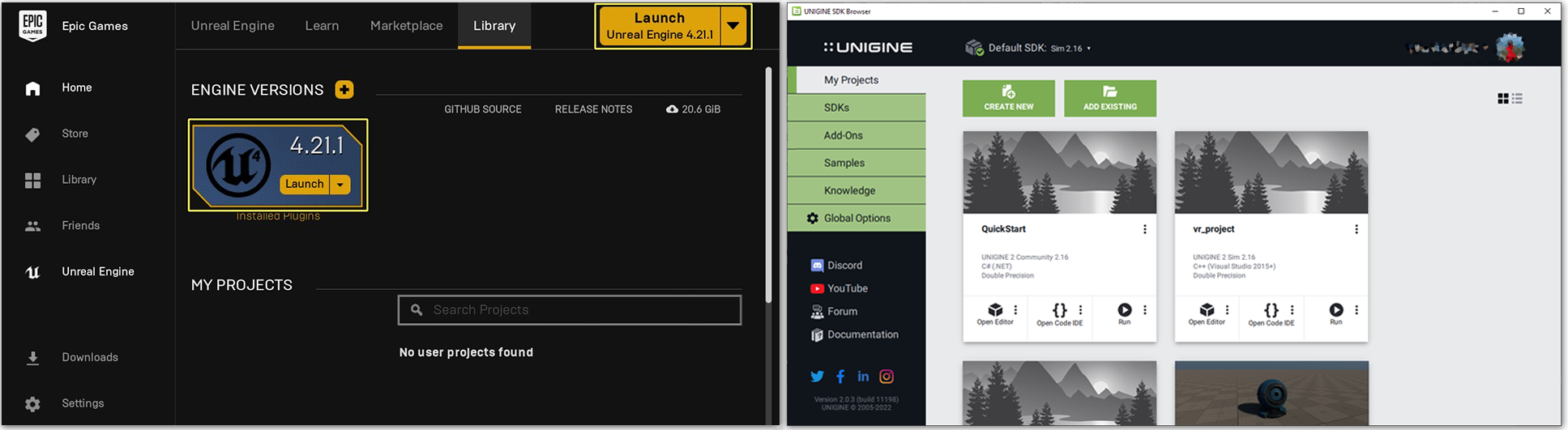

As an Unreal Engine user, you are accustomed to use Epic Games Launcher — the application that streamlines the way you find, download and manage your projects and installations. In addition to it, you can manage your projects directly via Unreal Editor: create a new project and switch between the existing ones.
UNIGINE SDK Browser is the first step to start working with UNIGINE Engine. This application incorporates all project-related tasks and enables you to manage your projects and installed SDKs, as well as gives you access to the samples and the knowledge base.
Epic Games Launcher and UNIGINE SDK Browser Comparison (click to enlarge)

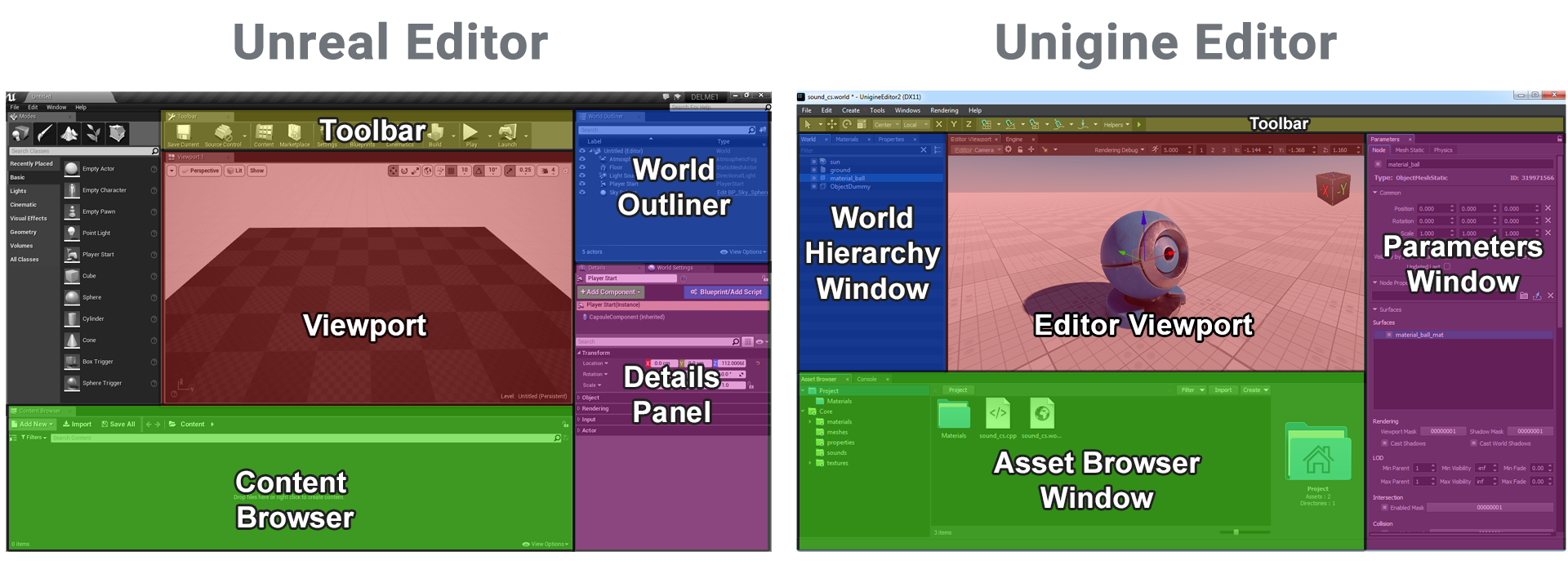

Editor Interface#
Below you can see interfaces of the Unreal Editor and UnigineEditor. Interface elements in the images are color-coded to indicate common functionality. Each element has a label to show UNIGINE's equivalent. The layout of UnigineEditor is fully customizable by resizing, dragging and dropping the tabbed windows.
Unreal and UNIGINE Editor UI Comparison (click to enlarge)
To learn more about the UnigineEditor interface, read this article.

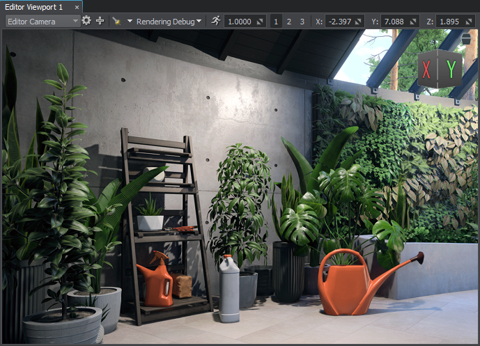

Viewports#

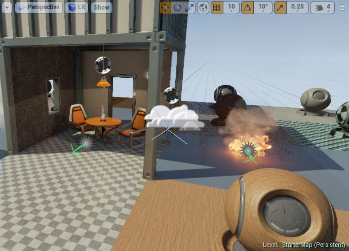

Unreal Editor Viewports and Editor Viewports in UnigineEditor are very much alike. You can use as many Editor Viewports as you need.
By default, an Editor Viewport renders its own Editor Camera view, and you can switch to another camera present in the scene and control it the same way as you pilot a CameraActor in UE.
Navigation inside Editor Viewports is pretty much the same as in UE Viewports. However, get familiar with Scene Navigation so as not to miss details.
UNIGINE Editor Viewport
You can use:
  • Camera panel to switch between cameras and configure the current one.

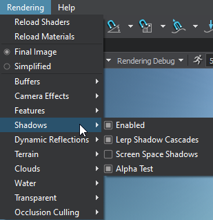

  • Rendering Debug to display the contents of rendering buffers the same way as using the Buffer Visualization Mode in UE4.
  • Navigation panel to quickly set up and switch between camera speed presets and change the camera position.
  • ViewCube to switch between the perspective/orthographic projections and control orientation of the camera.
Also, a set of switchers is available globally in the top toolbar:

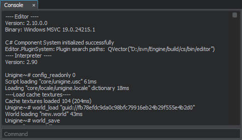

Output Log#
As well as UE4, UNIGINE has the Console used for standard input, output and error logging. A set of console commands is provided.
It is available both in UnigineEditor and a running application. To open the Console window in the Editor, go to Windows -> Console menu:
A built-in console is called by pressing the F1 key:
You can use it to print user messages from code.

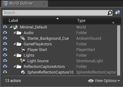

World Outliner
Basic scene object — Actor.
It is the base object that can be placed in or spawned into the world.
Actors can be organized into a hierarchy (parent-child relation).
Actor is a container for Components that define its functionality.
The Actor's position, rotation and scale are stored in a Scene Component. Usually Actors have a root component, which can be any subclass of Scene Component, by default.

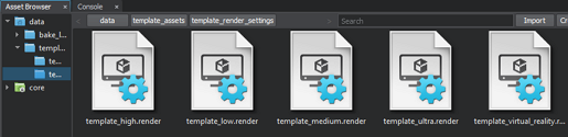

Saved Configurations#

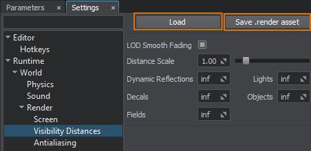

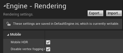

You use Export and Import buttons in the project settings of the Unreal Editor to save the values of the settings to an external configuration file (.ini) and load them when necessary.
In UNIGINE, you can save and load general physics, sound and render settings the same way. The presets are stored as assets with the *.physics, *.sound and *.render extensions respectively. Use Load and Save .* asset buttons of the Settings window to work with presets of the corresponding settings section.
Saved assets appear in the Asset Browser. You can load the render settings by double-clicking the required .render asset.
By default, a UNIGINE project provides settings for low, medium, high, ultra and virtual reality quality presets stored in the data/template_render_settings folder.
Presets are not an Editor-only feature in UNIGINE. You can use Physics, Sound and Render classes to manage presets for corresponding settings, for example, to switch between quality levels at run time.
