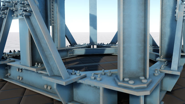

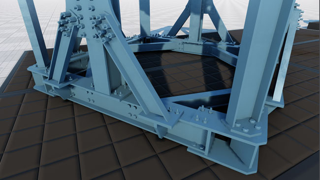

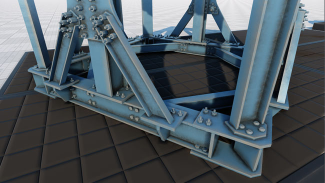

Various slits and cavities are prone to accumulating dirt and dust, while edges tend to wear, scratch and change their initial color, usually this is simulated using so-called curvature maps prepared for each model.
Using this effect allows you to perform curvature mapping (simulate worn scratched edges and accumulation of dirt and dust in cavities) in the screen space for all objects globally. It saves time for large complex scenes with a lot of various models and elements making them look more natural without having to prepare textures for each of them individually.

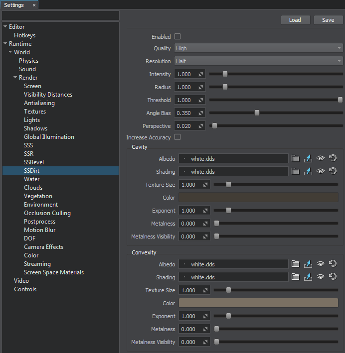

General Options#
Screen-Space Dirt Settings
Settings are applied to materials with the Procedural Effects and Dirt states enabled.
The Screen-Space Dirt effect uses additional geometry buffer (Rendering -> Buffers -> Additional Features). If the buffer is disabled, the effect won't be rendered.
Enabled The value indicating if the Screen-Space Dirt (SSDirt) effect is enabled. disabled by default.
Console access: render_ssdirt (API control)
Quality The quality for the SSDirt effect. SSDirt (see the SSDirt) must be enabled. Quality implies the number of samples used for the Screen-Space Dirt effect:
  • Low — 4 samples
  • Medium — 8 samples
  • High — 16 samples
  • Ultra — 32 samples
This parameter significantly affects performance, so choose it reasonably.
Option #3 is selected by default (see above).
Console access: render_ssdirt_quality (API control)
Resolution The resolution of the SSDirt effect. SSDirt (see the SSDirt) must be enabled.
One of the following values:
  • Full - full resolution
Console access: render_ssdirt_resolution (API control)
Intensity The intensity of the SSDirt effect.
  • By the minimum value of 0.0f, the effect is not visible.
  • Higher values make the effect more pronounced.
Console access: render_ssdirt_intensity (API control)
Radius The size of the SSDirt effect. SSDirt (see the SSDirt) must be enabled.
Console access: render_ssdirt_radius (API control)
Threshold The threshold of the SSDirt effect. It determines depth limit for the SSDirt effect in areas where information cannot be obtained. Higher values make the effect less pronounced. SSDirt (see the SSDirt) must be enabled.
Console access: render_ssdirt_threshold (API control)
Angle Bias The angle bias value to limit the SSDirt effect where information cannot be obtained. This parameter can be used to remove visual artefacts at the edges of polygons. SSDirt (see the SSDirt) must be enabled.
This parameter affects both, concave and convex areas.
Range of values: [0.0f, 1.0f]. The default value is : 0.35f.
Console access: render_ssdirt_angle_bias (API control)
Perspective The perspective value, that determines the degree of impact of distance from the camera on the radius of the Screen-Space Dirt effect.
  • 0.0f - radius of the effect is bound to screen space (it remains constant relative to screen size, regardless of the distance to the camera).
  • 1.0f - radius of the effect is bound to world space (it remains the same relative to objects, i.e. gets smaller as the camera moves away from them).
Range of values: [0.0f, 1.0f]. The default value is : 0.02f.
Console access: render_ssdirt_perspective (API control)
Increase Accuracy The value indicating if increased accuracy for the SSDirt effect. This option should be used to remove visual artefacts along the screen edges, in case if they appear. Otherwise, it should be disabled. SSDirt (see the SSDirt) must be enabled. disabled by default.
Console access: render_ssdirt_increase_accuracy (API control)
