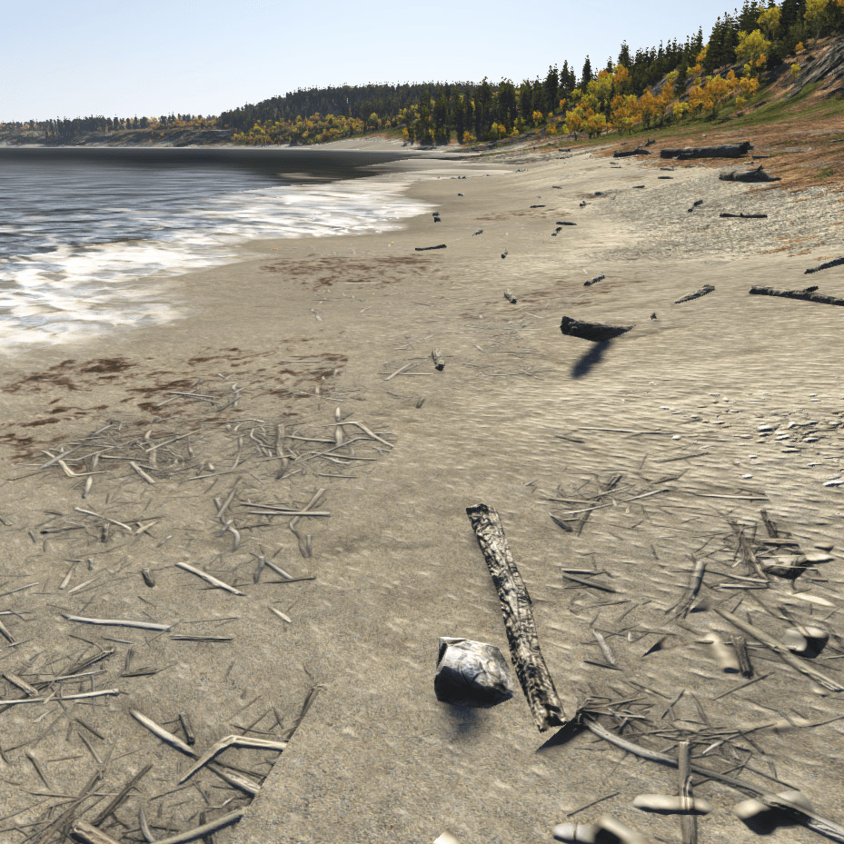

The World Clutter node allows scattering a set of identical nodes (node references) randomly across the scene practically in one click. There is no need any longer to position, scale, and rotate every single object by hand and constantly mind the performance factor. World Clutter automatically places nodes in the scene with random parameters, all of which can be efficiently controlled, and renders them only around the camera. World Clutter is used to scatter non-geometry objects, such as decals, particles systems, and so on. But if you want to scatter identical meshes, it is better to use Mesh Clutter.
World Clutter scatters objects procedurally and therefore even more memory-efficient. At the same time it means that scattered objects cannot be moved.
World Clutter uses only Reference Nodes, because when the world is loaded they are scattered around the camera much faster.

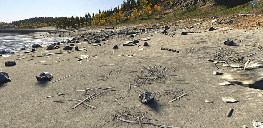

Scattered wood chips created using World Clutter

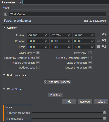

Objects in World Clutter are node references that are scattered throughout a definite area and for each of which the probability of its appearing is controlled.
Node references that are contained in the clutter
List of node references in World Clutter

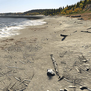

The higher the probability, the more often a node reference can be seen compared to other World Clutter objects. Let's say, we create a coast with wood chips and algae. We create wood chips decal and algae decal and save them as *.node files (create a NodeReference file). If the probability slider for algae is near to zero, the coast is thick with wood chips and only several algae are seen among them. Changing the probability of appearing does not affect the number of rendered objects, it only specifies the proportion between several World Clutter objects.

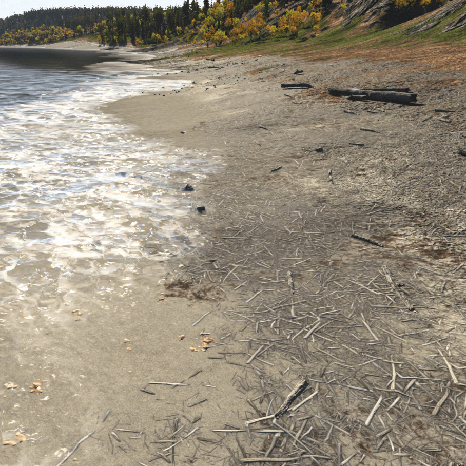

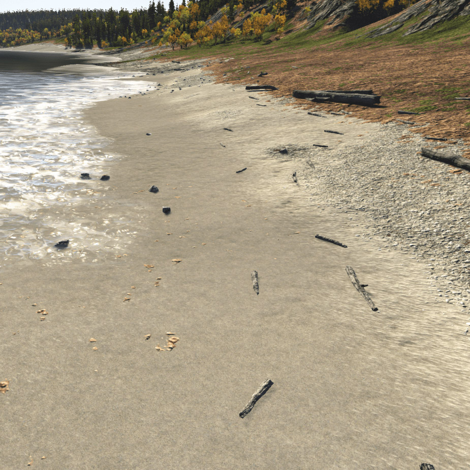

Density
Density specifies how many objects there are per square unit. In case there is more than one object in World Clutter, probability will be taken into account, but will not change the resulting number of all rendered objects.
If the density value is too high, objects can be penetrating each other.

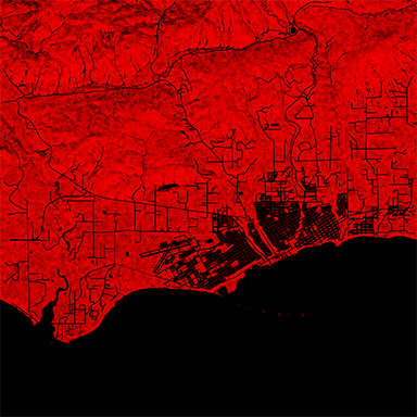

Image Mask
Areas across which the objects are randomly scattered and areas without any objects from the list. For example, on the terrain, a mask allows to scatter debris across certain areas, while leaving other places free of it.
When the image mask is not set, the default mask with maximum mask values will be used. The maximum mask value is 255.
  • The mask is one-channel texture (R8). If there are more channels in the provided mask, they will be ignored.
    • Zero color value specify the areas without World Clutter objects.
    • The higher the color value is, the more objects there are in this area and the denser they are positioned.
    • Color value of 255 means the density is as specified in by the corresponding parameter.
  • Masking is done for all objects that are contained in World Clutter list.

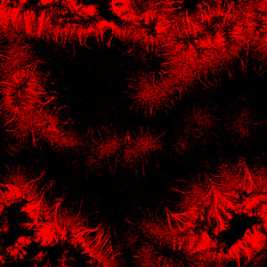

World Clutter mask for scattering
