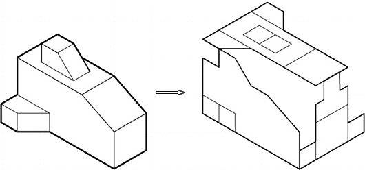

Orthographic projection is a form of parallel projection, where all the projection lines are orthogonal to the projection plane, resulting in every plane of the scene appearing in affine transformation on the viewing surface.

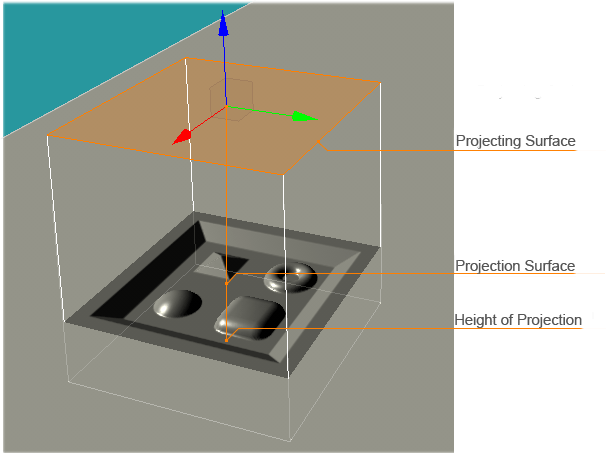

Orthographic Projection
Orthographic decals are the most reliable ones as projected from a surface and cannot cause unexpected artifacts (as may perspective projected decals).

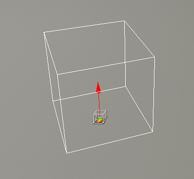

Orthographic Projection Box

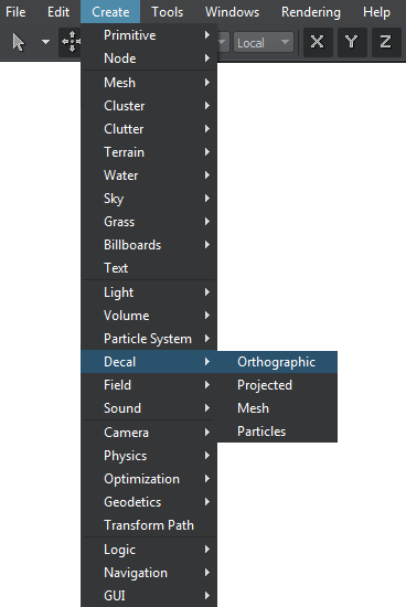

  1. On the Menu bar, choose Create -> Decal -> Orthographic.

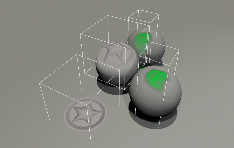

  2. Place the decal on the existing surface (for the decal to be projected, the projection box should intersect the surface) and specify the required settings:
    Placement of the orthographic decal

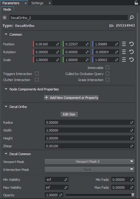

In the Node tab of the Parameters window, you can adjust the following parameters of the orthographic decal:
Decal Ortho tab
Decal Ortho#
Projection parameters of the orthographic decal:
Radius
The length of the projection box along the Z axis, in units.
Radius = 0.5
Radius = 1
The second case shows that the decal is projected only if its projection box intersects the surface.
Width The length of the projection box along the X axis, in units.
Height The length of the projection box along the Y axis, in units.
ZNear The value of the near clipping plane, ranging from 0 to 1.
