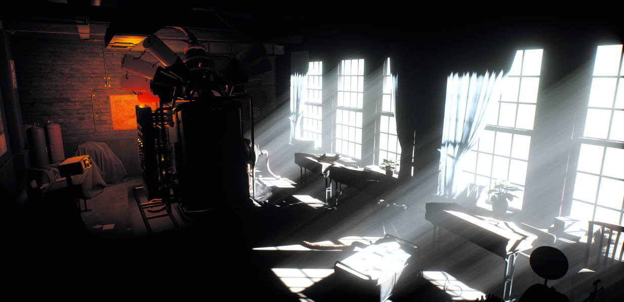

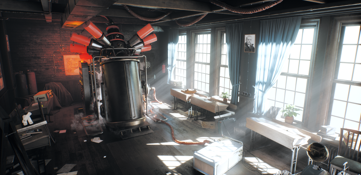

The following comparison shows the use of global illumination in a scene with two light sources: a red Omni Light and a World Light.
The left image shows the scene illuminated with direct light only, so that we see only silhouettes of unlit objects and a large number of details is hidden in the darkness.
The right image shows the scene with both direct and indirect light, which makes it look way more realistic and consistent.

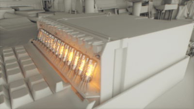

Lighting from all types of Light Sources is baked, however, note that both direct and indirect (bounced) light is baked from emissive objects, while light sources provide only indirect light for baking and are to be kept enabled to provide direct light and specular highlights.

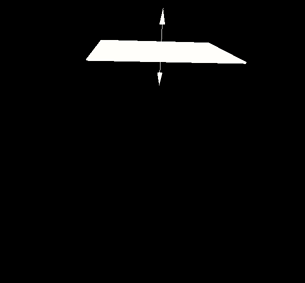

  • Dynamic. The light source provides direct realtime lighting only. It is considered disabled while light baking is being calculated, that is why the scene remains unlit when the light is turned off after light baking. No shadows are baked.
    Dynamic light source enabled. No GI is baked.
    Dynamic light source disabled.

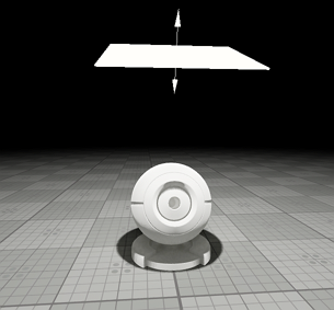

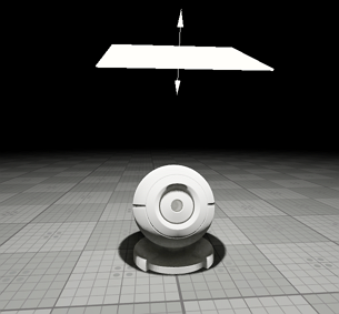

  • Static. The light source contributes to light baking and remains enabled all the time providing direct realtime lighting while the indirect light is being baked. When lighting is baked, such light sources are not to be moved and modified. Changing them can make lighting inconsistent and require re-baking. Shadows for Omni, Proj, and World lights are baked.
    Static light source enabled.

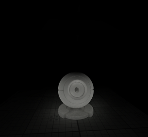

    Static light source disabled. Indirect light is baked into a Voxel Probe.

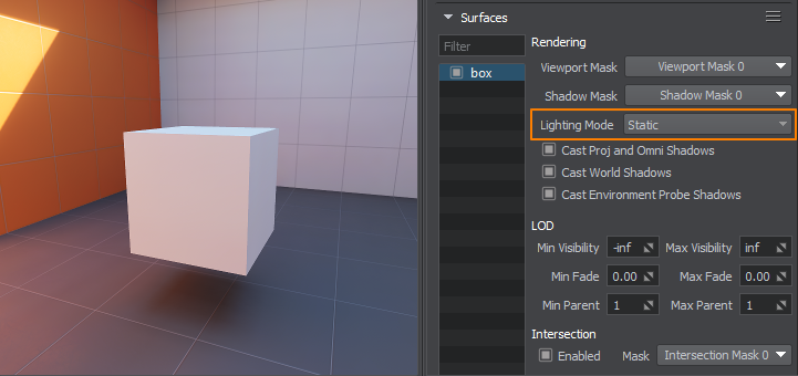

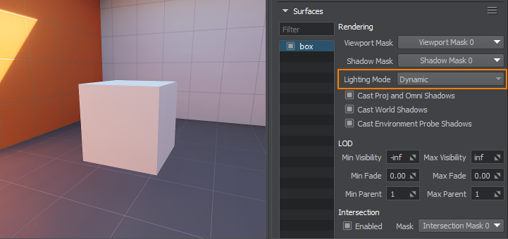

Use the Lighting Mode parameter to define how a surface contributes to lighting. The following modes are available:

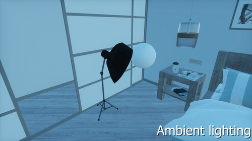

  • Ambient lighting from dynamic environment probes.
