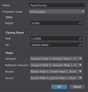

Camera Settings#
The list of available camera settings depends on the camera mode:
  • Perspective mode
  • Orthographic mode
Moreover, the Editor Camera has additional settings.

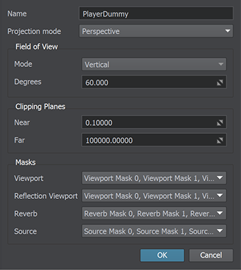

Perspective Camera Settings
Orthographic Camera Settings
Settings of the perspective camera, in turn, depend on the Mode of the camera field of view: parameters defining the camera's viewing frustum differ.
Option Description
Name Name of the current camera. If you change the camera name, the name of the node (PlayerDummy) will be also changed.
Projection mode
Camera projection mode. The available values are:
Perspective mode
Orthographic mode
Height
Height of the viewing volume which is represented in the form of a rectangular parallelepiped. The width of the viewing volume will be equal to its height.
The option is available only in the orthographic camera mode.
Field of View (available only for the perspective mode)
Mode
FOV mode. The available values are:
  • Vertical FOV is used for the standard camera. In this case, the FOV is set in degrees.
  • Physically-Based Camera is used for the physically-based camera with the horizontal FOV. In this case, the FOV is calculated depending on the film gate and focal length of the camera according to the formula:
    FOV = 2 * atan(film_gate / (2 * focal_length)) * UNIGINE_RAD2DEG
Vertical FOV Settings
Physically-Based Camera Settings
Degrees
Camera's vertical field of view in degrees. This is the area that can be seen in the viewport (how many degrees the camera covers).
Available for the camera with the vertical FOV only.
Focal Length
The focal length of the physically-based camera lens.
Available for the physically-based camera only.
Film Gate
The film gate for the physically-based camera with horizontal FOV.
Clipping Planes
Near Distance to the camera near clipping plane.
Far Distance to the camera far clipping plane.
An extremely big difference between the Near and Far Clipping Planes can cause black screen. Therefore, if the required Far Clipping Plane value is outside the range, adjust the Near Clipping value proportionately.

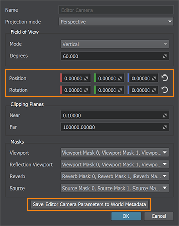

Editor Camera Settings#
In addition to the settings described above, the Editor Camera has some specific settings that allow you to change its transformation and then save it as the default one to the world meta file along with the other settings.
If the world meta file doesn't store Editor Camera transformation, the transformation of the main or any other user camera will be applied by default.
Option Description
Position Position of the Editor Camera.
Rotation Orientation of the Editor Camera.
Save Editor Camera Parameters to World Metadata Forces to save the Editor Camera settings to the .world.meta file. The Editor Camera settings of each Editor Viewport should be saved separately.
The saved Editor Camera transformation will be used as the default one. So the Editor Camera will be configured according to it when a new user will open the world for the first time.

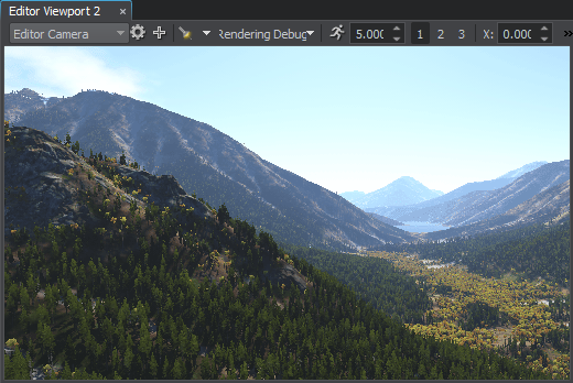

Rendering the Camera Viewport in a Separate Window#
The view from each camera can be rendered into a separate Editor Viewport window.
To render a view from a camera to a separate viewport, perform the following steps:
  1. Add a new Editor Viewport window, choose Windows -> Add Editor Viewport.
    A new viewport named Editor Viewport 2 will open.
    New Editor Viewport
  2. Select the required camera to render the view from in the drop-down list of the Camera panel.
    You can change the camera at any time, if necessary.
The total number of viewports that can be opened simultaneously is not limited. Each new viewport window has the same functionality as the main Editor Viewport window.
Each new viewport requires to render the scene one more time, which may lead to a performance drop. Don't forget to hide a viewport when it is not used, or remove it, when it is no longer needed.
You can use several Editor Viewports to operate with several nodes located far away from each other, or to view different orthographic projections of the scene (Top, Front, and Side views).
