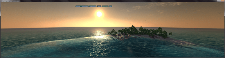

Surround on three monitors
Surround output onto three monitors
