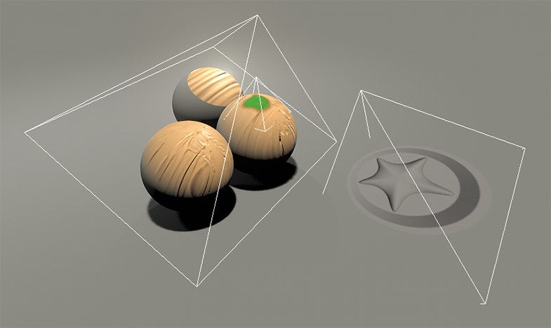

A projected decal is a decal projected onto a surface by means of perspective projection. You can create an instance of the image projected onto a surface from a single point as a cone. These decals are of the same scale in spite of how far the surface they are projected onto is.
Projected decals
Changing of the projection pyramid location relatively to the projection surface changes the size of the decal in accordance with the laws of perspective.

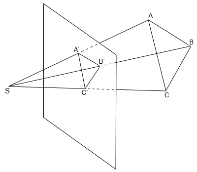

When the human eye views a scene, objects in the distance appear smaller than objects close by — this is known as perspective.
Perspective Projection
While orthographic projection ignores this effect to allow accurate measurements, perspective definition shows distant objects as smaller to provide additional realism.

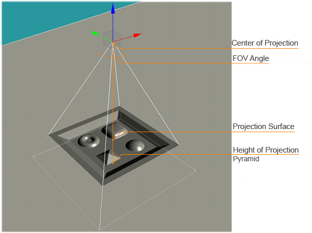

Perspective Projection Pyramid

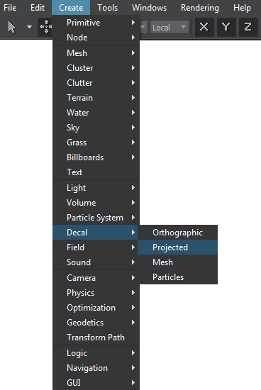

To create a projected decal, perform the following:
  1. In the Menu bar, choose Create -> Decal -> Projected.
  2. Place the decal on the existing surface (for the decal to be projected, the projection pyramid should intersect the surface) and specify the required settings:

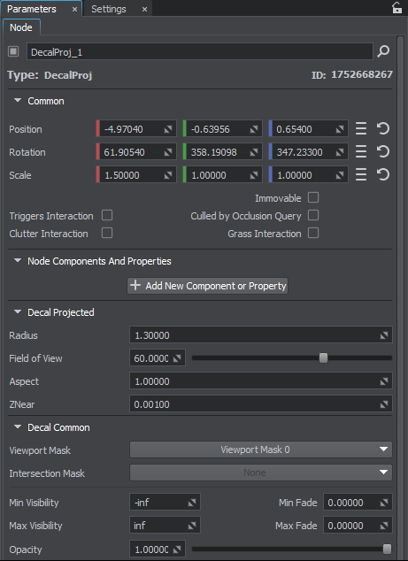

In the Node tab of the Parameters window, you can adjust the following parameters of the projected decal:
Node tab of a projected decal
Decal Projected#
Projection parameters of the projected decal:
Radius The height of the projection pyramid along the Z axis, in units.
Field of View The field of view of the decal's projector, in degrees.
Aspect The aspect ratio of the decal, in units.
ZNear The value of the near clipping plane, ranging from 0 to 1.
