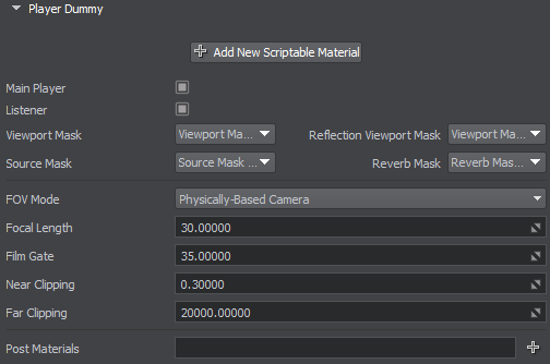

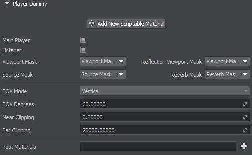

FOV Mode
Depending on the FOV Mode, parameters defining a player's viewing frustum differ:
  • Vertical FOV is used for the standard player. In this case, the FOV is set in degrees.
  • Physically-Based Camera is used for the physically-based player with the horizontal FOV. In this case, the FOV is calculated depending on the film gate and focal length of the camera according to the formula:
    FOV = 2 * atan(film_gate / (2 * focal_length)) * RAD2DEG
FOV Degrees The camera's vertical field of view, in degrees.
Focal Length Focal length of the physically-based camera lens, in millimeters. Determines the area that can be seen in the camera's viewport.
Film Gate Horizontal size of the film gate for the physically-based camera with horizontal FOV, in millimeters. Determines the area that can be seen in the camera's viewport.
