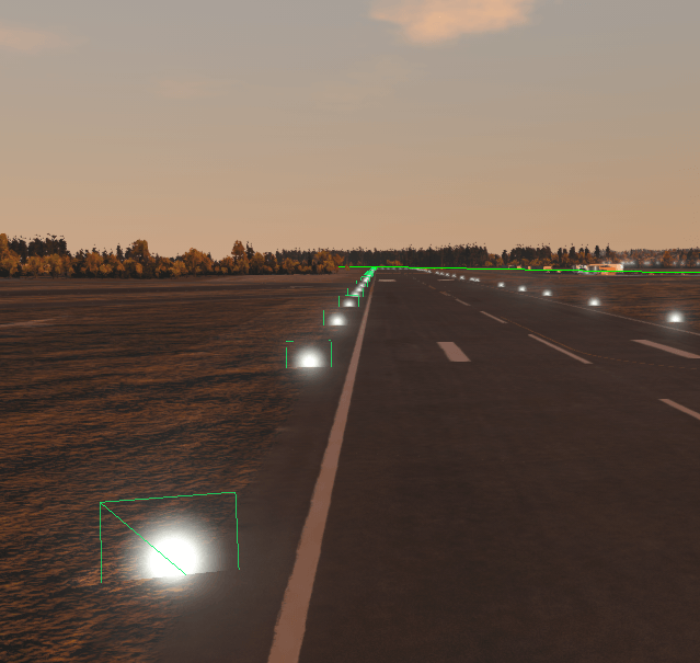

Using Billboards#
Billboards can be used to simulate small light sources observed from large distances. In such cases, only visualization of light sources matters. For example, you can use Billboards for takeoff runway lights. They don't produce any light, but look like real lights.
Billboards Used for Takeoff Runway Lights
To create Billboard that replaces a real light source, perform the following:
  1. Add a Billboard object to the scene by choosing Create -> Billboards -> Base in the Menu Bar and place it somewhere in the world.
  2. Assign a material inherited from the billboards_base material.
  3. Specify the following settings for this material:
    1. In the Common tab, set the blending Preset to Additive and toggle the Depth Write parameter off to avoid obstructing objects behind the Billboard.
    2. In the States tab, disable writing into the Deferred Buffers and enable the following states:
      • Emission to provide the emission effect by using the corresponding texture.
      • Geometry Inflation to limit the minimum Billboard screen size to a fixed value and, therefore, to provide visibility from far distances.
      • Soft Interaction to make interaction of the Billboard with other objects in the scene softer and avoid artifacts.
    3. In the Textures tab, specify the Diffuse and Emission textures.
    4. In the Parameters window, specify the following values:
      • Set the Diffuse color multiplier to black, so that Billboard become fully transparent.
      • Increase the Emission Scale to make Billboard brighter.
      • Increase the Geometry Parameters to scale the size of Billboard and limit the minimum size of Billboard.
      • Correct the Soft Interaction value, if necessary.
As a result, you get the Billboard that can be used to simulate a small light source at far distances. You can add any required number of Billboards to the existing Billboard object: in the Parameters window, select the created Billboard in the list and click Add.
Lights Simulated by Billboards
