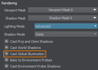

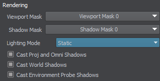

For a surface to contribute to static GI, it must have the Lighting Mode set to Static or have the Cast Global Illumination option enabled in the Advanced Lighting Mode. It must be turned off for dynamic surfaces.
Lightmapped surfaces are not shaded by Voxel Probes.

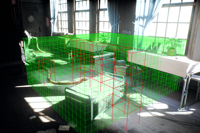

  1. Create and place one or several Voxel Probes at the places where the lighting remains relatively static (e.g. interiors, outdoor buldings, immovable objects).

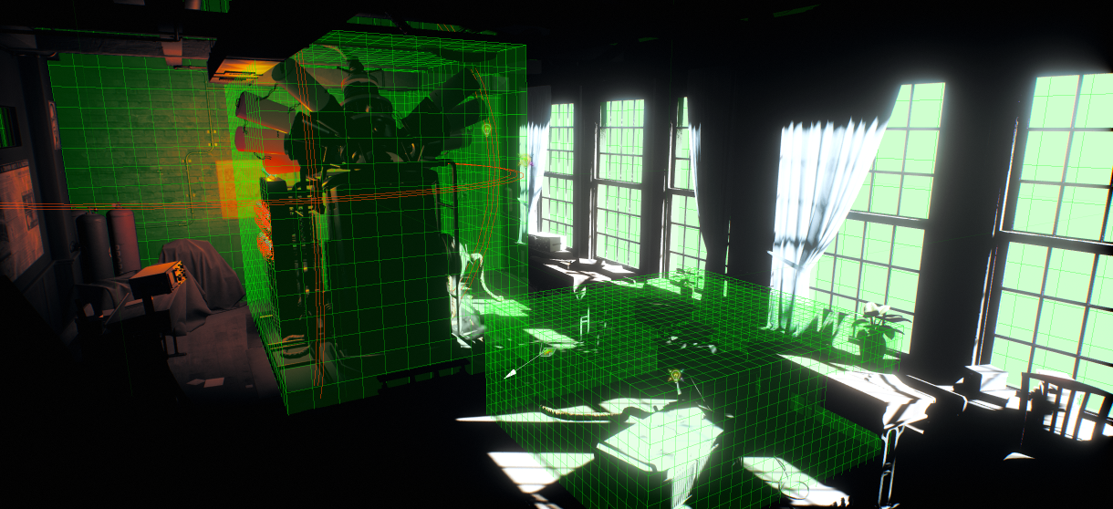

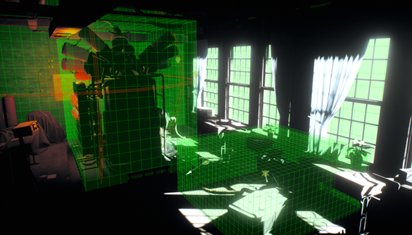

    Place voxel probes inside other voxel probes to create insets defining the areas that require higher detail. Note that voxel probes with the additive blending mode enabled cannot be used for this purpose, as they are blended instead of replacing each other.
  2. Set the Common Settings of probes, such as the Box Size and the Voxel Size. By configuring these parameters you define the resolution of the voxel grid and the video memory consumed by the probe.
    Do not use the Scale transform parameter to change the probe size as it causes visual artifacts.

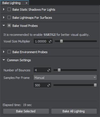

  1. Open the Bake Lighting window.
  2. Enable Bake Voxel Probes. Adjust the Voxel Size Multiplier, if needed.
  3. Adjust the Common settings:
    • Select the number of light ray bounces. Higher values will result in a brighter lighting since each voxel receives more photons.
    • Set the number of samples (voxels) calculated per frame. This parameter is available for adjustment during baking process.
  4. Start baking process by clicking Bake All Lighting and wait for it to finish. Live preview is available. Several iterations (one per bounce) will be simulated for each Voxel Probe.
    You can stop the process at any moment by using the Stop button and you will be prompted to keep the achieved result or restore the previous textures.
  5. Upon completion, generated lightmaps will be saved in the bake_lighting/voxel_probes folder and assigned to the corresponding Voxel Probes.
You can check the result by selecting the Indirect Lighting mode in the Rendering Debug.
If you are not satisfied with results on certain objects, you can select surfaces and/or nodes and perform partial re-bake using different settings by clicking Bake Selected.

Diffuse Reflections#
As each voxel of a Voxel Probe stores light data, a Voxel Probe is capable of providing diffuse (blurred) reflections at every spatial point within its volume provided Bake Internal Volume was enabled for baking. Control reflections by adjusting the Reflections Parameters.
Diffuse reflections provided by a voxel probe.
